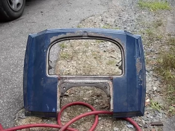

Well I had a cast iron Kettle type sitting on my new Resolute acclaim. Worked fine till one day My wife decided to put some poupori in it
It bubbled over the top and out the lid spilled onto the hot griddle and hit the enamal top part of the stove. About 3 days later the enamal came off all around the griddle opening
in little square chunks. This experiment resulted in removing and replacing the enamal top of the stove and nesitated just about a total rebuild to replace it correctly
My prefference is open steamers not closed in tea kettle ones that can boil over
I thought I would share this experience and hopefully prevent others from a very costly work intensive mistake
If you use a tea kettle one do not completely close the lid leave part way open will release pressure associated with boiling water and lessen chances of boil overs
Even hot boiling water hitting 600 degree cast iron can cause thermal shock to that cast iron. It could actually crack it
There are no tea Kettle sitting on my stoves any more, than for decoration when not in use. The next one will be an open top one
Note how one bad experience can ruin a new stove indicated in the picture below. Note wew did not see it actually happen but figured out how it occured afterwards
I did not know the poupori was in there till it bubbled up again the next day when I got a good glimps of what probably happened. My wife knew There was a bit more than water boiling

Good point, I leave the lid on mine off to one side to allow for more steam. My wife wanted to put some stinkwater in the kettle and I said no. Never guessed it would smoke the enamal. I even get upset when I set it on the stove cold and end up with lime or calcium deposits!
