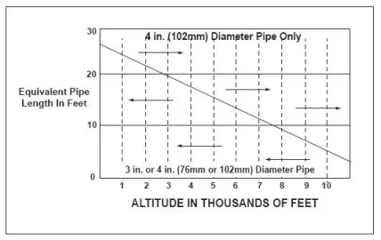

You Ran 3" flex Two stories?
I dont know what stove you have but every pellet stove I ever installed you have to have 4" venting if you have over 15" of vertical run.
I was at the upper limit for the Quad1200i, but still within the acceptable parameters for 20ft of pipe at sea level. The installer I spoke to where I purchased the stove and pipe said it would work, and it did. Never had any issue with it.
