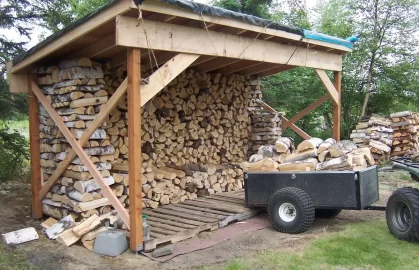

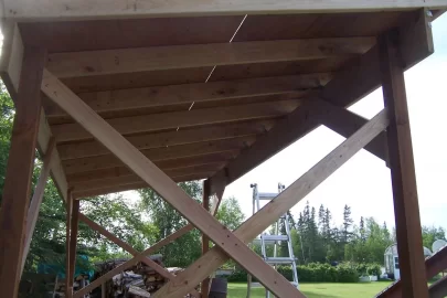

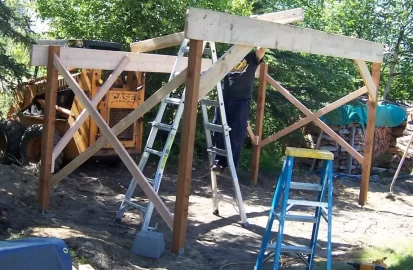

Picked the hottest day of the year to work on the wood shed.
This is the 1st of 3 sections, each to be 16' X 6'7" +/-
8' tall in front, 6'6" in back
Semi leveled a pad (old stump & roots)
Dug down to gravel, filled hole with rock/gravel/sand up to 1' deep
buried a pillar block
treated 4X4 posts, braces beams & roof. (hurricane clamps on roof for strong winter winds)
Raked fairly level, old carpet, pallets
Ready for wood
Well need to put on metal roofing or roll roofing to water proof it..

Filling this one with mostly "birch", 1 year + old.
I have to move the wood piles to make room for the next 16' section, so am putting in the oldest wood
to burn this coming season.
**Why no carpet?? Will help keep weeds from growing up thru the pallets. ?**
Back row is 6'6" X 15' X 1.5", the next 3 will be a little higher , maybe 7'+ high (roughly 5 cords)
Looks much better with wood in it. :)
I think the carpet is a great idea. He may not understand our dry cold and dry rain. Spring is our only damp month. ;-)

looks awsome im thinking about building one of these myself in the back yard. How much did it roughly cost? Im trying to come up with a list of all the materials needed.
Nice shed Dave, I was going to ask the same question that Rod just did. Dont you already have a similar shed or am I thinking of someone else in AK?
Each section 4 sheets of 1/2" ply wood, 9 - 92" studs -- 2x6 (on 24" centers), 1 16' 2X6 (optional, not needed but I covered the front of the roof trusses to help keep the wind from lifting so much on the ply wood), 1 16' 2X12 front , 1 - 16' 2X10 rear. 4 treated 8' 4X4s, 4 concrete pier blocks
I made 3 sections this size so 2 less pier blocks , 4X4 & "X" brace for the next sections. 3 rolls of roofing for the 48' total length. 6 2x4 studs (studs were cheaper than an 8' 2X4 & length didn't matter, just bracing.
I got the 16' stuff at Lowes on a reject warped/bowed pile pretty cheap. I put the bow up & was able to get the fronts pretty straight inline with the ATV winch as I nailed on the plywood. I built the roof 1" short of 8'X16' to have a little overlap of the plywood for a drip edge.
Don't remember the cost, $300 maybe for each section when all done. Could've been more, a guess
Prices here have gone up allot on lumber since the build, fuel shipping cost, everything has gone up.
VERY very glad I built it, easy to add another section too.
