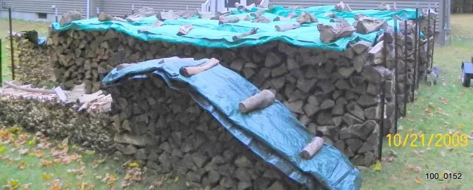

This is last years stacks on the south side of the house, the stacks are running east to west would they be better off running north to south?
Starting the hauling out of the woods today.

Zap I ran mine north and south so the winds would go through the middle of the rowes...are winds are mosthly south by south west
Given the house orientation, I think they are fine the way they are. Can you move the house?

I think you are good as our wind generally has a strong westerly component.

And with that west wind, the stacks should be running north-south for best results! You want the wind hitting the side of the pile, not the end.

Huh? That would only hit the pile on the outside. Let the wind blow between the rows.
Won't do much blowing between the rows at all. Better to have the air flowing through the stack (hitting the ends of the logs).
I got mine north and south the wind blowing between the row's hitting all the ends of the splits, not just the very end row.
Where it is looks perfect to me.
I stack mine where it fits.
Any wind will move thru the stacks if not real tight & close whatever direction the wind comes from.
Change the stack location & direction because the wind changed direction, :bug:
you'd be back to another source for heat in no time with all that work.
If you want the sun to hit both sides, go N/S, 6 to 8 feet apart.
If wind is the concern, put it on a turn-style so you can rotate it.
Come on guys. I know we're trying to maximize efficiency, but stacking your wood for wind direction where I live
would be "make work". The wind comes from all directions thru the course of a year.
Zap, Ask your wife where she wants it or where it fits & looks the best for you. You'll be much better off than asking us. :)

Thanks everyone, I'm thinking north - south with the wind hitting the face of the stacks. The stacks under the pines that I put up a picture of before running north/south dried better over the winter then the stacks that had been up longer but are running east-west.

I wouldn't worry so much about the east-west, north-south thing as i would to get that wood off the ground some!
Yep, get some skinny pallets and restack. (Just kidding) But pallets would be good for next time. Some of the rounds on the bottom layer will get a little funky, but will still burn if dried out first.
I like N-S stacking since the winds here are often W and NW. Let it hit the ends.

In answer to that question, it is best running north-south. Will wood dry okay another direction? Yes! He asked what is best and that is how it should be answered.
As for our stacks, if I were stacking and burning like quads, I would do it exactly the same....but I don't. I do not split wood in the woods. I cut in winter, split in spring and stack it then. Many moons ago I did not have quite so big of a wood pile so stacked for maximum drying, which is north-south in our area. (Actually SW in summer and NW in winter is the primary wind direction here.) Now I could stack anyplace and in any direction and now worry a bit as long as the wood did not set in water. But by habit, I still stack NS. If I change direction, it is SE to NW.
Dennis, you only stack your wood three rows deep, tight together so air that goes in one side will come out the other. Wood stacked more than 3 rows deep with spaces in between won't move air through the entire stack the same way.
What I am saying is to stack only one row deep if wanting maximum drying. I stack 3 rows or more but don't have to burn that wood right away either. I've had some wood stacks over 20 rows deep with no space between and it dried fine, but again, I don't have to use that wood for a few years.
Well... if we're talking one long row, I suspect his lot is not deep enough. There are two components to drying wood, heat and wind. The heat lowers the RH and the wind carries the moisture away. One long stack running E/W parallel and near to the house would probably work well too. The house would capture and reflect the heat and channel the wind as well.
