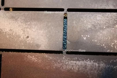

The Warranty (see attachment) this came with the stove. Look closely to the worded area relating to the 5 year aspect of the warranty against defects and workmanship on all steel parts. There is no listing for the steel brick panels or the steel baffle under the BURN GRATE since this is totally two different items within the stove box area. I would think that since the baffle and brick panels had to be manufactured, this would fall under: defects and workmanship on all steel parts. My back brick panel cracked in two places and the usage that I got out of them was just 2 months with the stoves operation on heat level # 3 and running on a T-stat set at 73* I have burned 31 lbs per 24hrs for the last 1 month. The stove would run a max of 32 minutes when called for heat.

If the cost of that S.S. Back Panel is what you say it is, I will find a place that can spot weld the two cracks, and put the new replacement panels away when they arrive.

I brought in a project Auburn more for my education and had called in about trying to trim down the feed (low is 16k btus)and questioned about the panels and was pretty floored by the cost for a really non functioning decorative part. Getting someone to weld the part should not be a big problem but it is kinda thin. Auburn went down the road to horse hay farmer to heat the mother in laws quarters.
I have the steel "bricks" on my stove, and can't imagine what could go wrong with them. They are heavy steel. If the baffle you refer to is the one above the firebox, ditto. That is one solid piece of steel, apparently stamped out. My stove is over 10 years old, which tells me that someone replaced the bricks before I got it. The baffle appears to be original, having the screw heads hold it in place, instead of the newer style "hooks".
