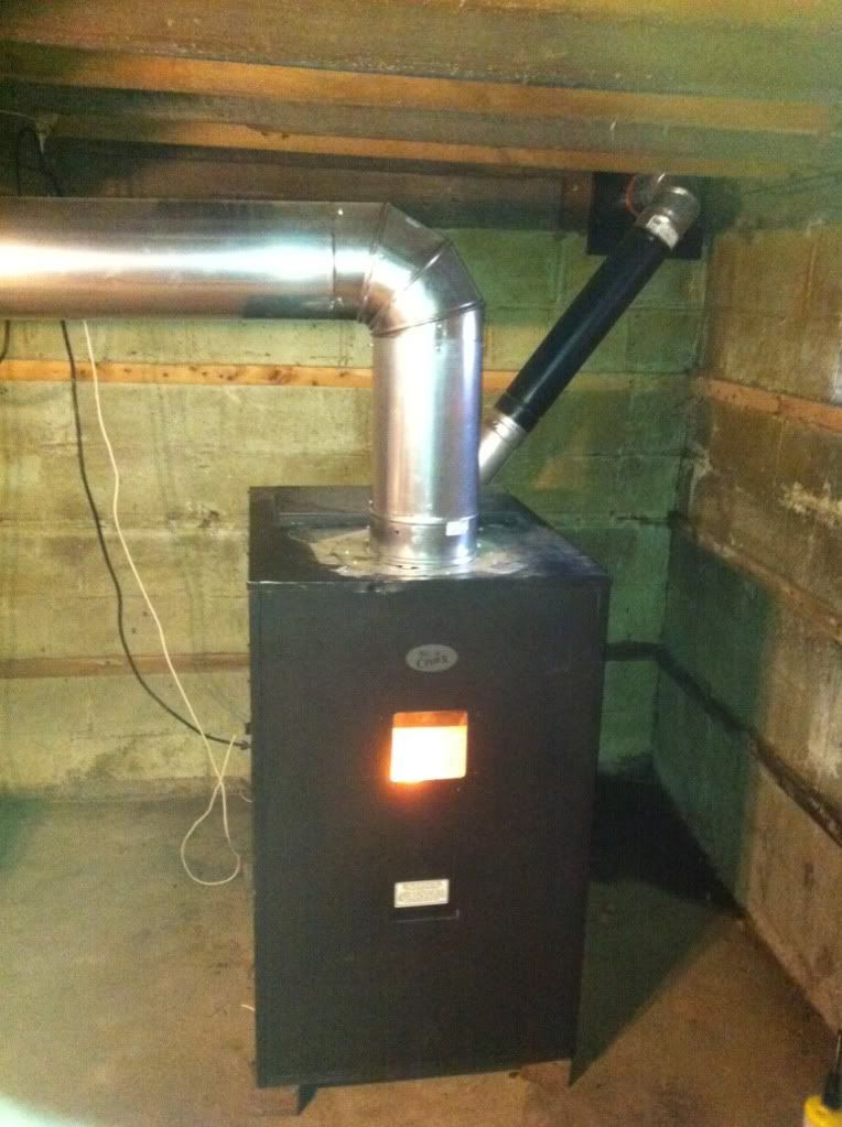

The furnace is installed in my basement it is vented through the sill and then up above my roof line has a total rise of 13 ft. It is ducted into the plenum of the existing oil furnace which is just blocked off with a piece of heavy cardboard. The cold air return is just open for right now but I opened the cold air duct work for the oil furnace up to the basement. The intake air is just open to the basement also as of right now I will change that eventually to pull in outside air. There are a few openings around basement windows that i will eventually seal up once get it setup to pull the air in from the outside.

The vent is 4" it goes from the furnace to a t cleanout then 5 ft at a 30* angle to a 90 3ft trough the sill to a 90 then up 8ft to a rain cap. The flow through the registers seems very good moves a towel hanging on the rack in the bathroom which it one of the longest runs. The ash seems like a nice fluffy grey ash. the soot on the window is light and wipes off real easy.

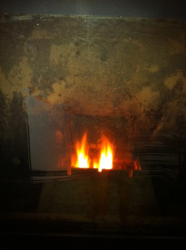

This is the flame on setting 1 pilot setting

Your pictures will not post because you have a space in the folders name. This site breaks links with spaces in them, Rename the folder Mobile Uploads to Mobile_Uploads and it will work!

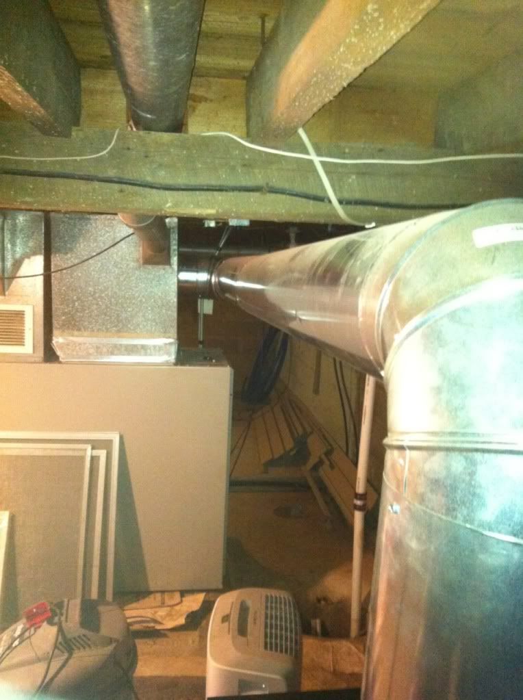

Thanks I was just wondering why they wouldn't show up as you can see the duct work is not insulated maybe that will be my next step.
I see 3 issues with the duct.
1.) it's not insulated
2.) Its 2 small
3.) Hook the pellet furnace to the cold air return. Also need proper dampers added.
If you reduced the ducting size from the pellet furnace you killed its air circulation ability's!
Its 8 inch duct which the manual does call for min. 10 inch. I thought this could be a problem however 8 inch was the biggest I could find. Any suggestions on where to get bigger? Or maybe it would just be worth the money to have a guy come in an do the duct work over for me. Not sure what that would end up costing me I don't have a ton of extra money hence why I did the install myself. Ill also look into getting some insulation for the duct work.

I am a bit of a noob myself, but I can tell you that if the furnace is malfunctioning, you will see it in the quality of the burn... My biggest issue is black glass due to ash clogs or clinker plugging up the gasification process....
Once a week the furnace gets a complete cleanout.... I made an extension for my shop vac with a garden hose, and it goes up into the ash covers... I also take off the cover where the heat exchanger scraper is....and clean out on top of the tubes....
The vent is sketchie but not much else you can do with a basement install. And its 4" so something you'll have to live with. Ash gives a good clue to burning decent. A dirty stove would be more of a black sooty color. So if the fire is brisk when on the high burn, I'd say its distribution.
Increasing the duct size will send more volume upstairs and connecting the return air will get the basement out of the heat loop. The pellet furnace should radiate enough to warm the basement. Getting the basement out of the loop will reduce the square-footage your heating with the ducted air. This will also increase the efficiency of the furnace!

The observation about lack of insulation is spot on just be sure to tape all of the joints before insulating, also the observation about the hot air side is spot on, you are causing unneeded stress on the convection blower by restricting its output side.

Thanks for all the advise i really appreciate it. I went and grabbed an infared thermometer from a friend to see what was going on with the duct work. Low and behold when I checked the temp at the base of the plenum I had 116 degrees and by the time i reached the top where the 90 is it was already cooled to 95 degrees I have 90 degrees at every register in the house when the fan is running. Once the fan shuts off the registers cool to 75-80 degrees in about 2 min. So my next step will be to get some insulation on the ducting and hookup the return and then I will go from there. Thanks again
Your actually measuring the duct surface temp. If you measured the actual air temp the loss will be slightly higher. If you insulate you still get initial some loss due to warming up the ducts, But once its warm you will see the temps rise on the registers. You will see some imediate results with the insulation, But this is only the start, You still need to improve the whole system. The damper first for safety sake! Larger ducting and getting the loop closed by connecting the return air to the pellet furnace. You also reduce you fuel usage in the long run so this has a payback along with a warmer house! Your not just throwing money at it! ;-)
Be certain to test the register temps because they should rise after you seal and insulate. You don't want any roasted piggies. But seriously you should tie the cold air return in and have the proper block offs installed.

Another thing to look into before you insulate the duct work is seal all the seams and joints with sealer.
You can buy a tub of it and apply with a paint brush. It may sound trivial but losses through these
seams and cracks adds up.
Since Saturday I have done some insulating and taping just the main sections for now. I also hooked up the cold air return which I feel made a big difference. For safety sake I also replaced the cardboard with a piece of sheet metal. I feel like I still need to do some more sealing up of the ducting. Once I tied in the return my convection fan was staying on constantly and It feels like I am getting nice warm air out of the registers feels like pretty good flow too. I think tonight I'll play with the fan off temp so I can get the fan to shut off so the furnace has a chance to come back up to the on temp. To get me through this winter I'm gonna try to utilize my current duct work. In the spring I will redo the whole system as it will be a good time to install a central air unit at that time. I would just like to say thank you to all of you for the help and suggestions I really appreciate it alot.
