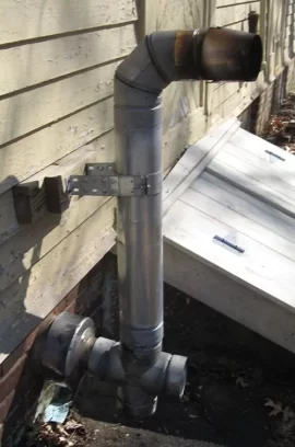

I've been fighting vacuum errors with this St. Croix Revolution furnace for the last two months. I clean it religiously, and pulled the combustion blower about a month ago - not much crap on it, but I cleaned what was there out. It got to the point where I had to sweep out the whole venting system at least once a week to keep it going, never that much came out (maybe enough to fill a beer can) but that would get it back up and going for a few more days. I could hear that the convection blower was getting very noisy, but it's a major teardown to get it out and I was hoping I could make it through to the spring. The furnace died altogether last night - now when I plug it in the power light comes on for maybe a second and immediately dies. So the main fuse isn't blown, but something in there is obviously drawing heavy current. I'm frankly seriously tired of dicking with it, and I have most of the half a tank of oil I bought at the beginning of the season left, so I'm gonna burn expensive dino juice for a couple of weeks and hope it gets me through. My main suspect is the combustion blower, although it seemed to spin freely when I had it out. Hate to think it's the control board.
