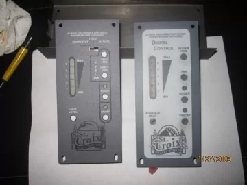

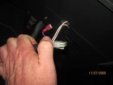

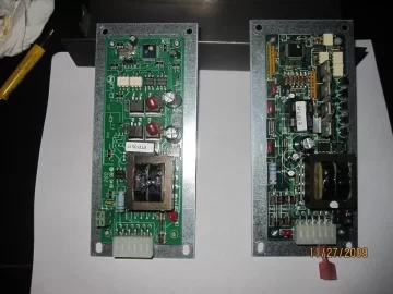

Off to dealer next day, throw nutty in showroom, who doesn't have parts in stock, service man was rude ect. Won't give me board off showroom floor, but agrees to overnight me new board. My stove is 2005 model, tells me new board version works. they overnight new board. I go to change it and there is an additional wire coming out of the harness with the main plug to plug into the control board. The old board has a wire coming out from under the board that this connects to. This new board does not have the wire coming out from under the board to connect to this extra wire.
In the attached pictures, the new board is on the left, the old on the right. Notice the connector coming out from under the board, that is what I'm talking about. In the third picture my thumb is on the extra wire which is purple and attaches inside the stove to the versagrate motor.
Anyone run into this or have any idea what to do?

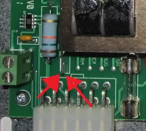

I think I have answered my own question. I took the old board off the face panel, the wire is just soldered into the board. I think it's supplying just power since the motor on the versagrate runs consistently. On the front of the new board, (cropped picture below), is a tab that the purple wire would connect to. What else would it be for? Hope I'm right.
  • St Croix Prescott new control board
Yes that was the correct connection.
