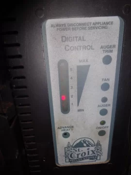

Did you unplug the insert before cleaning?
Then did you plug it back in and when the control board exited its power up sequence did you raise the heat range to 5.
If the stove loses power for any reason the controller resets into heat range 1 convection follows heat range.
Sounds like you have it either on T-Stat or Smartstat mode (that is what the On light flashing indicates) and it has lost connection with the thermostat. It will just idle along on #1 in that case. If you turn it to manual, it should go to 5. If that works, then troubleshoot your thermostat.
I don't have an insert, so I am not sure yours is the same, but it should be a small slide switch at the top of your controller just above your feed trim button (if you have the same controller). Make sure it is all the way to the right.
Here is your manual for further reference. See page 5 for the thermostat controls
Thank You All
It was a loose wire on the circuit board
