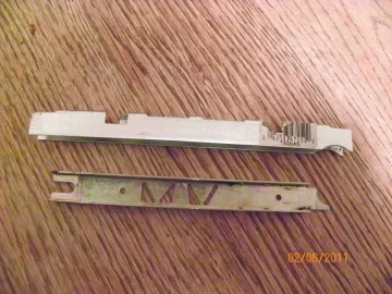

Have you taken the air compressor to the bar and sprocket yet? Pictured are two depth gauge tools used for cleaning your groove on your bar from the sprocket back.
Zap
  • [Hearth.com] Sprocket seized up

I bought them at my local Stihl dealer, you'll be surprised what comes out when you clean it. I had my sprocket jam when a piece of wood got jammed in there. I got it out with the small depth gauge tool.
