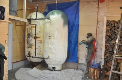

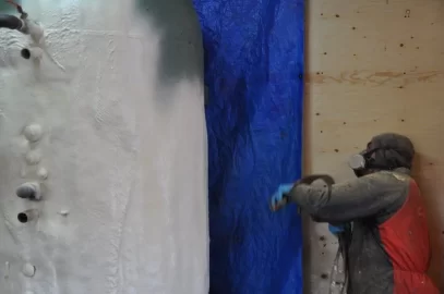

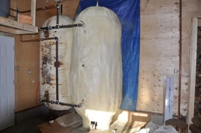

Yup tank was aboot 90 °F when sprayed, he applied it anywhere from 2" to 4" . I added another 62 gal. exp. tank too.

He had a hard time in the middle at the back , he had to crawl in the little hole between the two rims poor guy was claustrophobic he we was squirming like a stuck pig under there and in inadvertently sprayed a lot of extra foam :lol: . I was standing by to yank him out. He said he would bring a young skinny guy for the other one.
