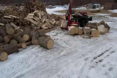

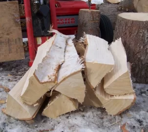

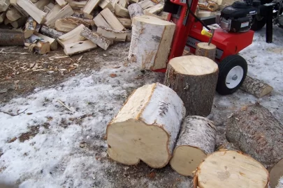

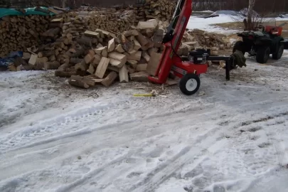

I think I could get used to splitting vertical pretty easy. It was less work on the lower back, allot less bending over & lifting.
Maybe I'm just getting old but pretty sweet & fun to have some big rounds to split. Got 8 splits from one round.
I cut the biggest healthy birch I've ever cut. So big I needed help getting it on the truck. 20" bar just barely made it.
Was cutting on the Parks highway upgrade clearing in Willow Ak, Got some big spruce too.
Anyway, vertical was the only way I could've split it. I don't think the maul would've done much but gave me more of a back ache.
I left a little angel on the beam so the round would stay on, so not fully vertical.
2 trips in 2 days, about 2-1/2 cords.

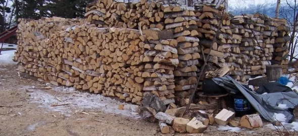

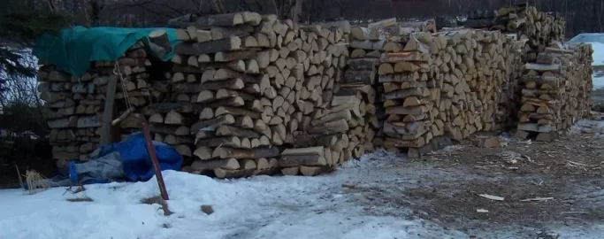

Couple more pics of splitting & new stacks/rows
As I was splitting, every once in a while I would see water oozing out around the wedge just before
it split. When it was frozen it split easier.
I still can't believe some folks are burning this right after the cut it. Hard to believe it even burns.
What a waste of "what could be good wood & lots of BTUs"

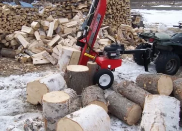

When I tipped it up, there was some ice in the way & it didn't go full vertical. Just didn't know any better.
I rolled a log over & when I stood it up it slid on the splitter just fine, no lifting & it stayed.
Not a need to lift, only about 3" off the ground, roll the round over to the shoe & stand it up, slides back to the beam pretty easy.
I do have t use the hatchet to cut some strings every now & then that are still holding the round together but same for horizontal.
but the round stays till I cut the strings then falls off.
