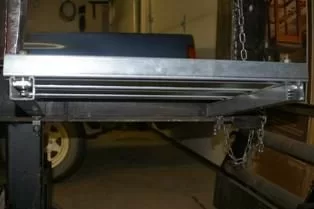

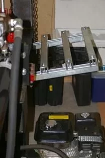

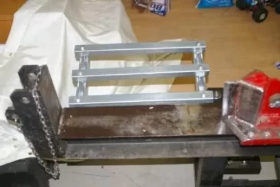

I made mine out of a couple of beam clamps, some spring nuts, and some unistrut. If you know any commercial electricians, just use those terms and he / she will be able to fix you up. If you like I could go snap a pic or two for you. Total cost less then $ 30.00

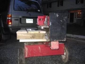

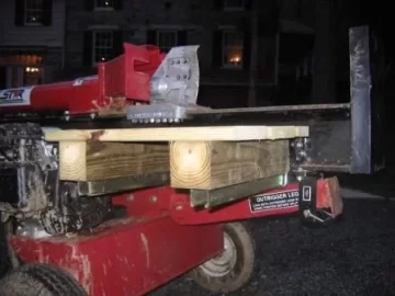

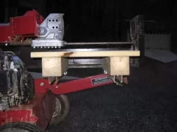

I was able to scrounge some Kindorf free and ordered 2 beam clamps from Grainger. I'll mount some 2x4 or 4x4 to the top of the Kindorf to act as a screw bed, then run some 5/4 decking for the top of the platform. I should be all in for about $20. Thanks for the suggestions everyone.
Here are the pics I offered, sorry it took a little longer. I guess mine is a bit more of a log catcher, more so then a splitting table. I should also add that it has only seem limited use. I suspect that it will allow bark and other debris to fall thru and hold only the larger split pieces, which is what I wanted. Let me know if you have any other questions.

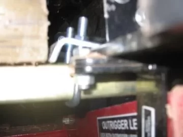

Well here it is. As stated above, the kindorf was free and the rest was about $20. I'm quite pleased with the final result and was able to sit on it with no apparent problem. The only change I may make is to add a guard along the engine side to prevent anything from rolling onto the motor, though I really don't see that as a significant concern. The last pic is a little blurry, but shows the type of beam clamp I used.

North -
I haven't had a chance to use it yet, but I figure it should the amount of lifting I do roughly in half. The back should be thrilled, as well as the stomach from needing less Advil at the end of the day.
