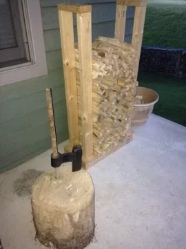

30 minutes with my new jigView attachment 184306
I built it from some scrap i had around the barn. I cant take credit for the idea, I got it from this youtube video:Did you buy or build that jig?
its actually just a splitting wedge. i narrowed the edge and then took a grinder and ground off the hardened steel down to "soft" steel where i was going to make the weld. then i just welded a peice of plate to the wedge and then i piece of tube stock to the plate.Where did you get that Axe head? Its not a common type.
