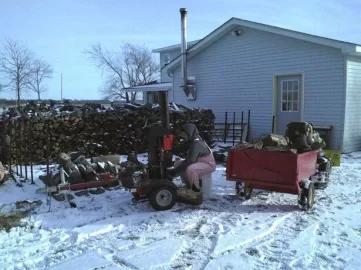

Your right I can burn brick! lol and do. With a draw that is just unreal. Heavy winds in all directions. You can see the stack is clear of smoke!
