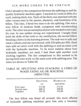

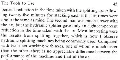

Just finished a good book called "Splitting Firewood" by David Tresemer. The author did a lot of careful testing to determine the efficiency of different splitting methods. Thought I'd pass on some of his conclusions.
TOOL COMPARISON (Time to split 1/5 cord)
Hydraulic Splitter: 30 minutes
Splitting maul: 34
Monster Maul: 34
Chopper 1: 35
Wedge on Handle: 46
Felling Ax 46
Sledgehammer and Wedges: 49
Wedge on Stand: 52

The numbers don't sound right - Hydraulic Splitter: 30 minutes for 1/5 of a cord that 2.5 hour per cord. That seems slow.
Around here that is about right with the splitter. Three beers.
With a maul. A week or so. A case.
Perhaps that chap (or lady) does not know very well how to split wood! Especially using a hydraulic splitter. If it took that long to split a cord of wood, I certainly would find a better way. Methinks most of his figures are pretty sad, but we don't know much about the fellow or lady who was doing the splitting. Also, what length was the wood that he was splitting? It certainly is easier to split a 12" log versus an 18" one.
Did that author by any chance state what wood he was splitting? Did he state that some wood splits better through the heart and others on the edge?
Interesting results.Either his splitter is slow or I'm tougher than I thought.I'll bet a seasoned cord of sugar-maple I could outdo that particular splitter with my 8lb. maul; if I had a good night's sleep, and a good breakfast, and a load of gun-barrel pinewood,and there wasn't a cold beer in sight. :smirk:

It might help to report that the book was printed in 1981, so a lot of things have changed since then as far as splitters, technology, etc.
Sounds like the splitter they used had a 30 second recycle time.

it takes a pretty big splitter to split wood faster than a man in good physical condition can split it.
it's all about cycle time, if you have some nice straight grained stuff that splits easily, you can outrun most "affordable" splitters.
