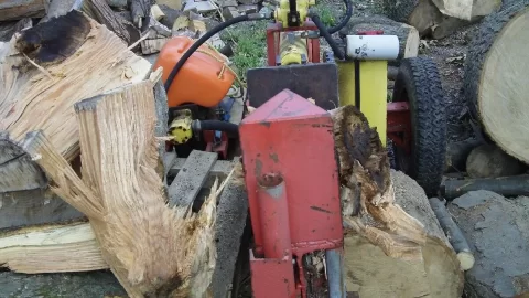

Here is a picture of our 20 ton MTD. Yes, it is under that tarp. We've had that splitter over 20 years now and stored it just like that until last year when we put up a new barn. I always made sure I laid down two boards under each tire and the other things you've mentioned.
