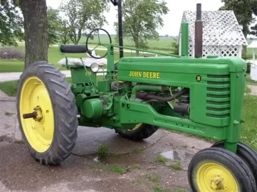

I've got a John Deere B (1948). I've got Hydraulics and a PTO to work with, but this doesn't have a 3pt hitch. is there something that would work well (and be lower cost) that could split well?
Here she is. Don't be fooled by the recent paint job. This aint for parades. She likes to work even though she lives on my parents farm and is semi-retired.

ok, so i downloaded the pic and then just uploaded straight to the forum.
  • [Hearth.com] Splitter and John Deere B
NICE, keep her workin danno
