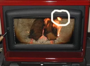

BUT , With the cat stove you still have to have a set abount of BTU;s to light off the cat . Point being made is how much more BTU's for the larger firebox ?/////////////////

****BUT **** I agree with the lager stove needs more "heat / BTU's" to run vs the smaller stove box . ***BUT*** I dont think its going to make that big of difference to the point that you cant run the bigger stove in the smaller sq size house . I think your CAN run the bigger stove . The difference between the bigger stove and the smaller stove to run at its minimum heat range to run correct is so low in the BTU scale that its not going to make the difference . Lets take the large Pacific Energy Summit with 97,000 BTU as max rated vs a mid size stove max rated at 45,000 BTU's . ( not that we would run at max BTU's ) To run the stove at minimum to get secondary burn we are talking what ....... 12,000 -18,000 BTu's for example ? The small amount of BTU"s to get secondary burn is on the low side and the low side to get the larger stove to get secondary burn is low enough that its not going to run you out of the smaller size home / room to be debated . Pictured below is my Pacific Energy Summit stove heating our home when its around 55° out side . Not much heat is needed when its not that cold out side , correct . In the picture your will see 2 things . #1 low heat from two small logs in a larger stove rated at max 97k btu. #2 the second thing you will see is circled the secondary burn flames . Low heat + big fire box ( 3cf ) and still get secondary burn . You could run this large size wood stove in half the size house and be able to keep the heat where you wanted it . Again , I think the Soapstone stove is in its own class .
  • [Hearth.com] Spin off from the Heritage or Mansfield thread...Min BTUs of a Stove

Roo, I cannot comment on PE stove; never burnt one. I can comment on Regency, since I owned two different sizes in the same model line.
I would ask, what did the smoke output look like when you took that pic?

In the pic the coal bed is hot and wood seen is a reload , No outside smoke . The secondary burner is firing .
