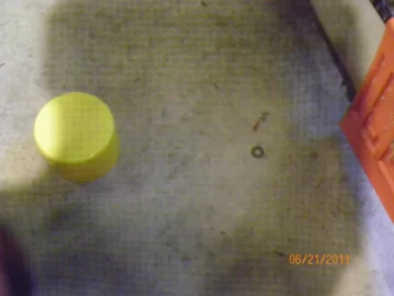

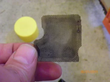

Smokin here are two pictures right after I snapped the bolt off and before I cleaned it. Never took the after picture.

Not enough to choke it but as you can see that air flow had to be slow down some what. Very fine screen I might add.
That is the original screen, bought the 310 in the summer of 2008 and this is the first time checking the screen.
