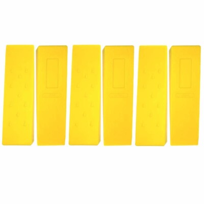

Hmm, I ordered those last spring and hoped they were actually good:
Amazon product ASIN B01N8U6IQP

I bought these & have a couple of Stihl plastic wedges as well. A 10# maul/hammer may be a bit much for driving them in. I use the back of my hatchet or a 16oz hammer. Mine have deformed a little but not much. I support everyone else’s comments on junking chains on steel wedges. I have knicked my plastic wedges several times & no damage to the chain.
No steel wedges here.
I've had these for 10yrs, and have held up very well. And they've been beaten to death, but have very little wear. I can pound them into knotted oak, where they bend and bind, yet come out fully intact without chips or marks. Felling is a very mild use with these. They fit nicely in a back pocket, so can carry them around when cutting without noticing them. Bright green, so almost impossible to loose.
