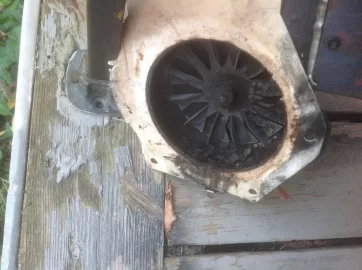

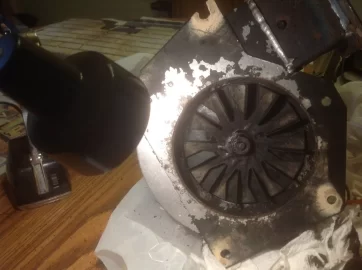

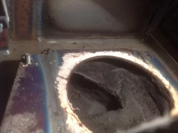

Photo of combustion fan before and after. It spins freely. [Hearth.com] Someone come fix my stove please[Hearth.com] Someone come fix my stove please [Hearth.com] Someone come fix my stove please[Hearth.com] Someone come fix my stove please

Yes. I used the ash vac up the port where I took the exhaust motor out. Used a brush, vac and the air hose to blast out all the ash from the ash traps and the 2 ash port holes behind the brick.
We leaf blowered the vent without the stove attached. Did a pretty good job with the air compressor.
I hope the cleaning helps a lot. From what I see in the pics of the combustion blower before cleaning, your stove was starved for air and was running WAY too rich.....there should be NO black, shiny, creosote-looking coatings anywhere in a pellet stove. Looks to me to be a VERY dirty stove.

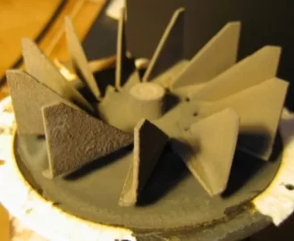

This is what a dirty comb. blower should look like (after 1 1/2 tons):

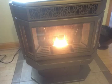

Update:
I bypassed the high limit switch with a jump wire and so far so good!

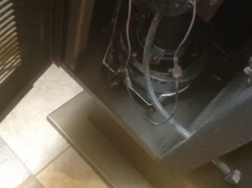

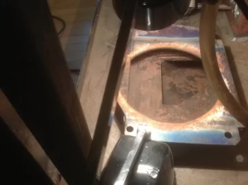

Will have to order a new one tomorrow and fix the firebrick that cracked all the way through this summer[Hearth.com] Someone come fix my stove please[Hearth.com] Someone come fix my stove please
