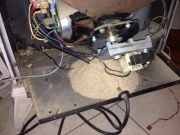

Picture 1 a Whitfield Renaissance, 20 years old, all original, needs it's first part...auger bushing. This stove was also called a Waterford Erin

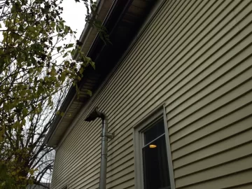

Picture 2 Englander vented wrong, no air kit, too close to window and soffit vents pulling emissions in to the attic living space

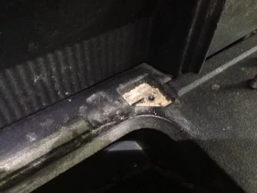

Picture 4 here's what cause the cast hopper lid to crack... Dust in the hingethe hinge

Thanks for the pic. I am glad you showed the Whitfield one, I just noticed sawdust forming around the auger motor of my Prodigy II. Looks like next year will be bushing time!
Don't forget the auger plate gasket when you replace the bushing. You get fines through there too.
Earl:
This is copied and lasted from Mike at Englander from that thread " ive always been of the opinion that its like drawing a box around the window (4ft away below , 4 ft to each side and 1 ft above the window), the exhaust termination cannot be within that box."
If you draw the box as he describes if your are 1' above the window than no matter where you vent you would NOT be IN that box..
Maybe that vent is not a foot above...
Sad thing is the one going into the attic vents may have been professionally installed.
is that al soot on the soffit? wow.
