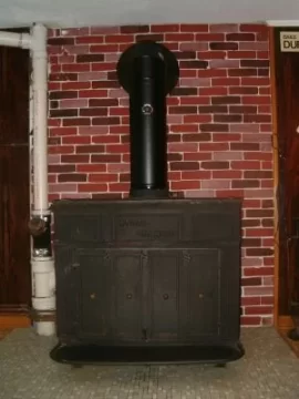

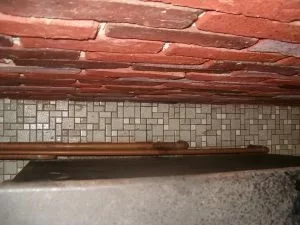

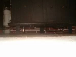

These pics show the water pipes that go into my stove. I'd like to disconnect the stove from the water and just use it as a regular stove. Is that possible? It's called a hydro-heate and manufactured in 1980. The company doesn't do stove anymore so it's been really hard to find info on it. Any help would be great!

The second and third pics show the pipes rinning into the stove.. can these be disconnected fron the water supply and the stove still be useable??
Just my opinion, but I would take a close look at how the stove is set up. If there is some component...say a coil or water jacket setup...inside the stove that was designed to always have water in it, it might not like being burned dry. The water would keep the surfaces at no more than about 212F degrees, or maybe slightly higher (230-250 ish) if the system is pressurized. With no water, internal stove temps could easily be 1,000F or higher which is a considerable jump.

It needs to be evaluated. Can't tell anything from your photos. It may be as simple as deleting the stove and looping the pipe, but there certainly can be more involved. This heated water goes out to radiators? What will heat the water once disconnected from the stove? What's wrong with leaving it hooked in?
If you feel uncomfortable evaluating the situation, it would be wise to get a professional opinion, even if you plan to do the work yourself.

Yes, the heated water gets puched to the radiators. I have an oil furnace that heats my water. The reason that I don't want to leave it hooked up is because if the power goes out I'm screwed with no heat. The stove can't run without the circulator on.
BUT.. I did manage to get intouch with someone in PA that is familiar with this stove and said that unhooking and draining it was in fact ok.
