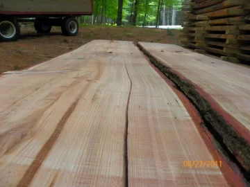

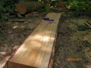

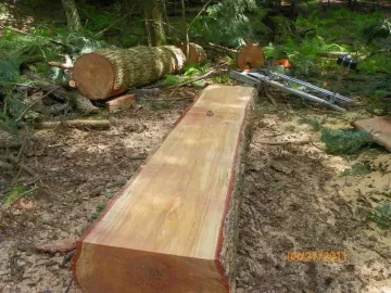

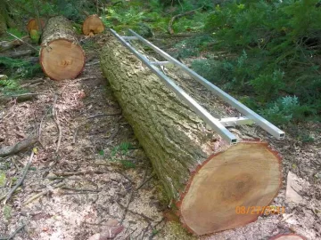

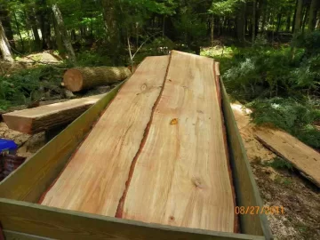

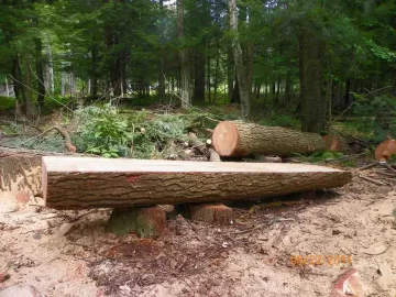

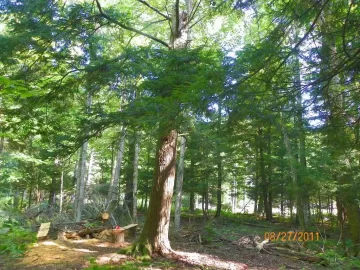

Had a topped off Hemlock that I dropped then we milled most of one log which is 8' 6" in length. Milled the boards 1.25 inches thick with the widest 20 inches, we milled 6 boards today but could only bring out four.
I'm not sure the correct term but the board would crack on the left side on all the boards (stress fracture) when we finished milling that board. Used Wesson Veggie Oil in the aux. oiler and Wesson Canola Oil in the 660 with the 36 inch bar.

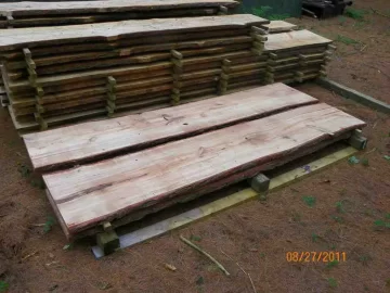

We would like about 60 more boards before the snow hits. We are only slabbing but it is getting easier each time out. When we took a break our little friend came by so we gave him half a granola bar.

XactLEE said:
Shake.
Word used to describe the crack your talking about.
Thanks XactLEE, we still should get some nice boards once we trim them up.

XactLEE said:

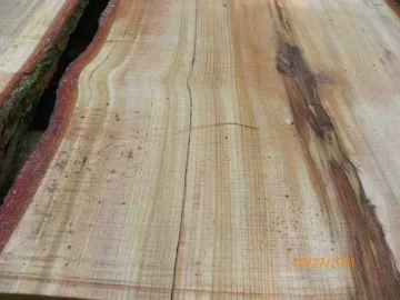

Shake.
This is one of the boards that split on the left side, the board is flipped over.

Zap, enjoy those dips in the brook because that water will get pretty cold real soon. Good for you too getting the lumber and a nice job of stacking.
Hemlock is notorious for ring shake like that. I had to cut around a bunch of it for my recent siding project. The good thing is that you don't necessarily lose too much in terms of board feet because the shake is usually quite vertical. I used the scrap for stickers or kindling, nothing wasted.

I guess I have a slightly less favorable opinion of the smell of the wood itself. (I think it smells a bit like crap.) But the pitch pockets in the bark do smell nice and piney. The scraps I burned outside didn't seem to give off a particularly distinctive smell.
