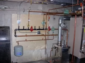

Pictures of the recent install.

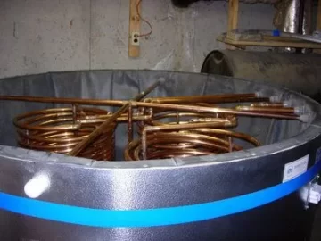

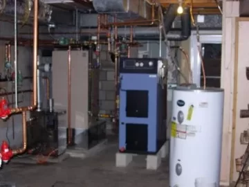

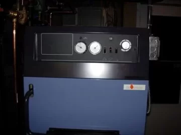

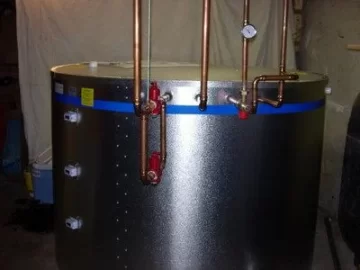

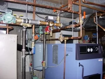

Nice looking install,Did you use the Tarm diagram?Now all we need is some cold temps.Have you done a first firing yet?

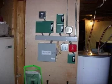

Yes we did follow the Tarm diagram with the fossil fuel backup and the Stss storage tank. Had to add an extra relay for the air handler. I think it is going to work out well. Had a small test fire last night and today we heated the tank up to 165, I would never have guessed that the house temperature could be regulated so precisely with a wood fire.
The electric water heater was being used temporarily until the Tarm was installed. The one thing I can not figure out is will I be able to use the oil boiler to heat the tank in summer for hot water once in a while.
