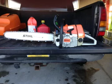

So a couple weeks ago I bought an 036 Pro project saw. The P & C were toast and the saw had been run hard with the chain brake engaged. I found an OEM cylinder locally and bought a new Meteor piston for it. I also fixed the chain brake damage, put on a new clutch and rim sprocket and a new 3/8 20" bar with 2 chisel chains. I got it assembled this morning, started it and tuned it. Tomorrow I am gonna go cut some wood with it so while still clean I snapped some photos for you all to enjoy.
