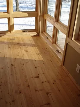

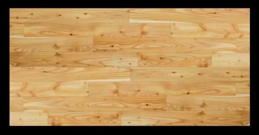

Lot of my friends have put tamarcak larc floor in there house. It's making an awesome looking floor, the grain id really prominent, i like it, I.ve seen some that were stain too, it awesome. But none of my friends have radiant floor. And as it's not hard wood, I wouldn't put in in the living room or kitchen.
I am thinking of putting in in the 4 bedroom of the second floor. I have a lot of tamarack larch on my property. So when / if ever «i have time, I could easilly cut 50 tree and get my flooring out of it. I will go with staple under for radiant heat for my second floor !
What do you guys think ? Is soft wood floor can be suitable for radiant heat ?
I could go with narrow plank, 2 to 2.5 in, and even thinking of maybe getting it quarter sawn. I thnik I can get it cut & dry (under 15% humidity) for under 1$ per sqft. Then I would have to install it (Most likely myself) and either oil or varnish.
