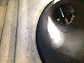

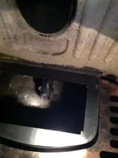

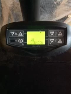

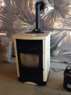

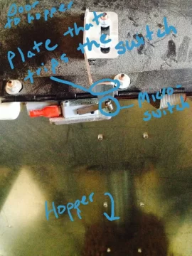

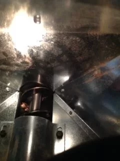

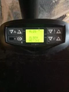

Stove: Sofia Ecoteck--beautiful stove, dealer installed Oct 2013. I burned high quality pellets and swept stove every morning. Worked well for a couple weeks, then got the following error message: "Alarm Active" "No Lighting." It goes through the clean cycle and stops.
Tried: Priming the auger. No change. Auger does not prime or appear to attempt to move.
Tried: Cleaning everything. No change. Emptied hopper as much as possible. No change.
Tried: Restarting stove. No change.
I'm assuming this is a pilot light issue?
Any thoughts before I call the guys back out to the house? I've attached some pictures, maybe this will help. Thanks for any help/advice. (Pics: stove, burnpot, auger in empty hopper, tunnel from auger to burnpot, under burnpot, and error messages)
