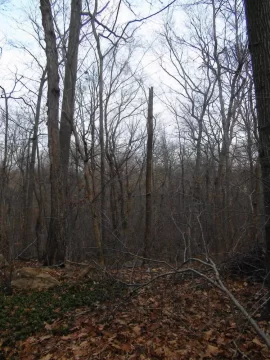

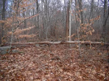

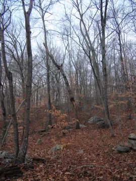

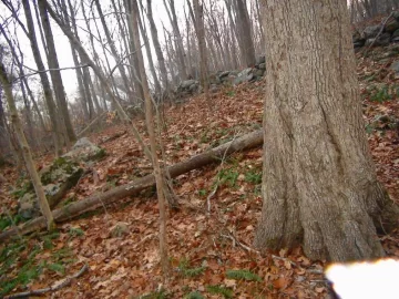

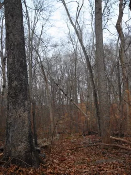

Hey all,
Just an update with some photos. I scouted the whole area today and took some photos. There are a lot of standing dead ones, plus countless fallen ones. Here are the pictures. There are only 5 pictures, but they are typical of the entire area. Maybe the pics will spur some more replies on the cords per acre estimates.

If you cut only broken, overcrowded, or similar trees on your property, I predict 3 cords per year without any noticeable change in the forest, probably double that. I would guess a 25 acre woodland preserve would yield five to ten cords per year of new fallen trees and large limbs, plus any existing dead wood on the ground. The first year you'll want to cut double or triple your yearly use, and there should be lots of older dead stuff on the ground to cover that. Later, you'll cut only a year's worth of wood, but won't need to burn what you are cutting for a couple of years. Once you are ahead a ouple of years, I think you'll want to cut the newly down wood, because it will be cleaner and more solid than a lot of the older dead wood. There will be lots of new fallen wood to choose.
I think the challenge will be moving the wood out of the preserve, not finding enough. Are there trails and will they allow you to use a four wheeler or something like that to move wood?
