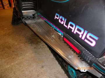

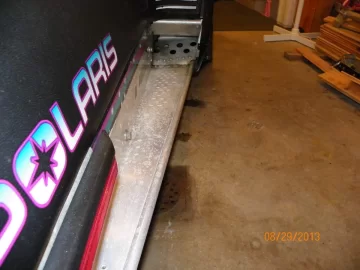

Took some super fine steel wool to the tunnel on the left side, the first two pics are before & after. I did it with super fine steel wool dry then with the super fine steel wool with a spray bottle, like wet sanding.

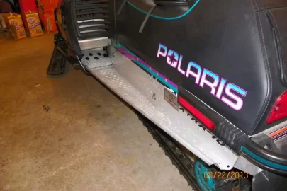

The last two pics are the left side (done with super fine steel wool) the right side is cleaned up with SLEDBRITE tunnel cleaner.
Once I polish it up then put a sealant on it they should look great. I still have another hour or two on the side I worked on tonight, then I'll polish them after we have the engines checked out.

looks good but a word of caution, when rubbing steel wool on a softer surface it is common to have steel fiber stick into the softer material, hence they will rust down the road, might want to switch to a nylon abrasive such as a Scotchbrite pad.
I polished my Chaparral SSX340 once......yes, once. It was a PITA, so I know what you went through doing that job Woody. Looks great, I'll give you that. I agree on the steel wool causing rust. I'd be going to scotch brite on the next polish job...
