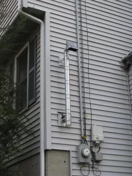

Chuck- Did you by chance remove the cap off your cleanout T when you cleaned the stove?
Yep. put it back on, when I was done, too.
And even if it fell off...its outside. my chimney goes out, then up.
Ok... hmmm... it seems like you have an exaust leak somewhere.
when you replaced the "T" did you goop that up with silly-cone? sorry, just saw you said its outside. the most common place for exhaust leak, from my experience, is right at the mating point of the pipe to the stove flange. That whole cast flange to steel pipe interface is ornery sometimes.
Yeah...I'm going to go after that joint again w/ the goop. Its really hard to access, as the stove is tight to the corner. The only sealant I could find was the caulking gun tube, and its impossible to maneuver that thing in such a tight space. I'm going to transfer some goop to a small syringe, and see if I can't get that in around the underside of things a little better.

put on a rubber glove, squirt RTV into palm, dangle yourself behind the stove and smear it like crazy. when you think you have enough, put a lil more....think of it like BBQ sauce....theres never too much on there. %-P
Ok, I've re-gooped. we'll see if it worked when it cools off again. (been warm the last few days).
