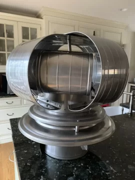

The first thing I did was to install a chimney cap (there wasn’t one). I chose a Vacu-Stack unit, and installed it. It seems to have solved the downdraft problem I had, which is great.

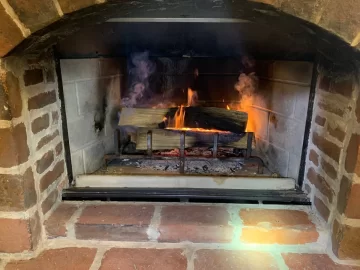

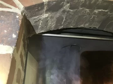

However I’m not out of the woods, the fireplace still leaks some smoke, rolling up the front top lip.
I’m burning it now, it’s hot, burning at 800 degrees, burning dry pin oak, dampers are open. Should be pretty ideal conditions.

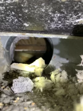

I thought there was an OAK, but it looks like it’s actually just a hole from the outside into my basement ceiling, probably the remnants of a basement clothes dryer vent.
I’m guessing this is a problem that the previous owners had, because the HVAC return vents in this room are blocked.
Still, I am getting some smoke roll off the top of the firebox and into the room.
I don’t think it’s a negative pressure issue - cracking a door helps solve the problem when the fire is starting but not once the chimney is hot.

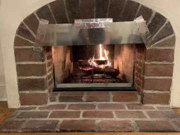

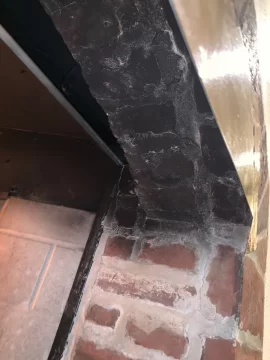

When you look at the front of the fireplace, the firebox is actually below the top of the arch. Could it be that installing a simple Smoke Guard would solve my problem? I was thinking of a 4” sheet metal between the masonry and the firebox, to square off the opening.
