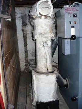

muncybob said:
Glad you got the smoking fixed, now insulate the piping and collector and you'll be good to go!
Do you have a pic of how you insulated yours? Just for a point of reference.

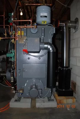

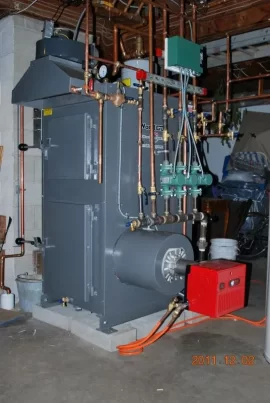

Inifinity and Gasifier,
Between all of your collective posts, I've solved just about every one of my learning curve issues. I've had my E-100 ss up since December 1 and I'm loving it! Most of my present wood supply is silver maple I took down back in March, so it's a bit wet (and soft), but I've also got some equally moist red oak that's working well. I've had a little mit of moisture problem, but mostly when its warm (45-50) outside. I actually had it dripping out of the load door and onto the floor below. The flyash pan is still dry though. Thanks for all of your posts!
WOW! SWEET SYSTEM BRO! I see you got all the goodies...SS, OIL, DHW, Smoke Hood. Did you get the low temp shut off and cycle time?
Did you do the work?
I had brown water drip out of the load door and stain the lower door. I can't get it off. I had to adjust the hinge bolts and removed a shim plat on the latch to tighten up the door. Now I noticed brown water dripping out of the cover plate where the oil chamber would go. Every bolt was loose.

Way to sneak up on us there Dude. I mean FarmerTan. Nice system. Can you figure out a way to make your pictures bigger? I want to check that system out a little closer. Is the oil burner from AHS as well? Please tell us a little bit about the install. We like details, and pictures. What kind of shape are you in for your wood supply for next year? You and Infinity Mike have to get enough wood c/s/s so that is will dry for next year. I have approximately 28 cord of wood c/s/s for next year. (face cord)That will be a very important for both of you. I feel much better now that I have my wood put up for 2012/13. Now it is time to start working on the 2013/14. My vacation just started tonight! :coolsmile:
Hey guys, I just posted my album to Photobucket.com Check it out at http://s577.photobucket.com/albums/ss212/gainestyler/Boiler install/ I had not initially intended to get the hood, it seemed a trivial add-on. However, I am so glad that I did. You really can get a good amount of smoke billowing out, and it handles it very nicely. I have it ducted through 4 inch aluminum druer vent through my shop and outside. Funny thing about that is that we're really stretching to be able to afford this system, and had to get it financed. Because of that we had to have a licensed pro install it. Its a good thing too, because although I could probably have done it, especialy during the summer, there's no way I would have the time to do it during the school year (I'm a teacher). Plus, the funding took so long to secure that in the meantime we went into the "off season" for boiler purchasing, so AHS had a 15% off sale. That saved us a bundle and helped pay for the hood. Unfortunately I did not buy either the draft cycle timer nor the low temp cutoff, so using the thing during the shoulder season is a bit tricky. Plus, the circulators are wired to come on whenever the thermostats are calling for heat, regardless of the boiler temp. So, the first few days I came home to a 70 degree boiler with all three circulator pumps running and the draft fan going as well. I ended up lighting the boiler, bringing it up to temp and getting the house up to about 74 before going to bed. Then I turned the boiler and all of the thremostats off and went to bed. The following day when I got home from school I would light it off again. This way I didn't waste the wood and the temp only dropped to 100. It still bothers me that the circ pumps run like that. I', trying to figure how I can use the oil switchover aquastat to cut out the circ pumps. I got a call into Daren at AHS and he's looking into it, but I haven't had time to pursue that or do anything about it. I think that I am going to spring the $229 for the low temp cutoff though. As for wood, I'm not in real good shape yet. I've got 2 cords from August (Storm Irene) stacked up and another 3-4 still to split and stack before the snow flies. I've got about 2 that I cut in March, and that's a little bit wet still, but is burning fairly well. Fortunately I've got a neighbor who is real helpful (he runs his own landscaping business) and helps me get wood. I work for him for free, he bills $55/hr, and gives me the wood - delivered right to my back yard. Nevertheless, I've still got to convince my wife that a truck is a NEED, not just a want. Her most recent idea was to get a trailer for her little station wagon. The we traded that car for a nice little C240. Well, ain't no trailer going on that. It's a win-win. She gets a nice car and I'll be able to get a truck. Anyway, that's enough for now. Thanks again for posting all that great info. I look forward to some more idea sharing. Cheers, Gaines
P.S. Infinity, we live in Preston. Near the largest casino in North America - Foxwoods. Not that I care, we're not into that. Branford is about an hour southwest of us.
I don't know why, but I cannot post the url correctly. If you look at what is there, put the percent sign followed by 20 in the gap between Boiler and Install and you'll get there.

infinitymike said:
Here's a shot. The only piping not wrapped is the black pipe from boiler to the vertical stack...ran out of the insulation. I would like to wrap the insulation to cut down on any fibers that come off when you brush up against it(only happens when I remove the horizontal pipe to get at the chimney)...any suggestions out there? The stuff works great...piping was well over 200 but the outside of the insulation was below 90.
