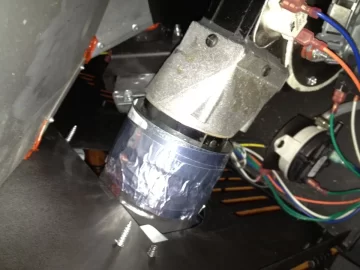

Last night after reading that smoke in the home is usually from the vent of the stove I started digging. I did the lights off with a flashlight trick (as suggested on here) and saw smoke coming from the cleanout on the T and that was it. I spent a little bit of time plugging the holes on the T with some high temp silicone sealant and put it back in. Voila! No smoke from the T anymore! But then I realized that I could smell the smoke and could not see it.
I did some more research and then started putting some leftover silver tape over all of the joints. I sealed some of the joints that I could with some with silicone and to no evail I can still smell the smoke and cannot locate where it is coming from.
