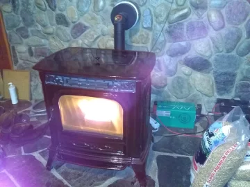

I run AIMS 1250 to mine to keep it running or shut it down. Couple 100ah Batteries (200AH Batteries going in next Season)
  • [Hearth.com] Smoke Coming Out of Pellet Stove When Power Goes Out
