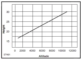

Not to be contrary, but at 7500ft I think you will need more chimney, with bracing and the wind cap, though I'm not sure if you need an OAK. One way to tell is to open a nearby window a 1/2" while watching the fire. If the fire perks up and burns more briskly then yes, add an OAK. If not, try the first two and see how it goes. This chart is for a different stove (VC Encore). It illustrates the relationship of altitude to chimney height to maintain sufficient draft. Also, is the interior connector single or double-wall? To keep the flue gases as hot as possible I would use double-wall connector in this situation.
