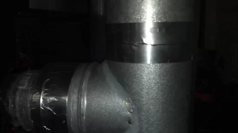

I use it on all my exhaust vent joints that have to come apart. When I did my install, some of them were leaking. They don't leak anymore.DemonGT said:anyone else use high temp tape? that seems like something that is do able. who sells high temp tape?
DirtyDave said:good high quality foil tape like that sticks very well and is a pain to get off. leaves heavy sticky residue when removed. that is why they use it when installing new furnaces in garages and other confined spaces.... 1 it seals. 2 it shows if tampered with. 3 the county inspector loves it.
DemonGT said:Dexter, is the tape you use the 3m flue tape?
