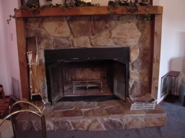

That is one tiny opening. Some stoves are close, but off by an inch is off by a mile. Can you post a picture that shows the fireplace and the hearth? Maybe there is an alternative that doesn't (or does) have a chisel involved.

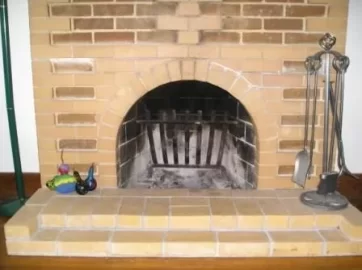

It seems depth would be easier to work around than the others, but maybe not. I will post a picture and see if anyone has any ideas. Thank you for all the responses.
WH
I have attached a picture
  • [Hearth.com] Smallest insert available?

I have the same question, but seem to have an even smaller opening. You may want to look at the Country Stove Striker C160. It appears that it needs an opening of 18 1/2 H; 23 1/8 W; 14 D. Because of the arch in my opening, even that won't fit in my fireplace. (See below.)

Tim on H, that fireplace I'd look into attaching a thimble further above into the flue, putting a freestanding stove on the hearth.
Whardy7, is the inside of your fireplace cast iron? My fireplace originally had a cast iron fireplace, on removal a normal masonry fireplace was behind it. If that makes any sense... I should've taken a picture of the cast iron thing pulled out, the cast iron thing had it's own damper and grate. After removal the normal fireplace was still there, intact, even had firebrick, ash dump, and damper.
I was thinking of the Striker as well, but that requires 25.5 width. I also like the Lopi Answer, though slightly too big with current specs. However, I think Rhone has it correct. There may be more space with the cast front removed.
