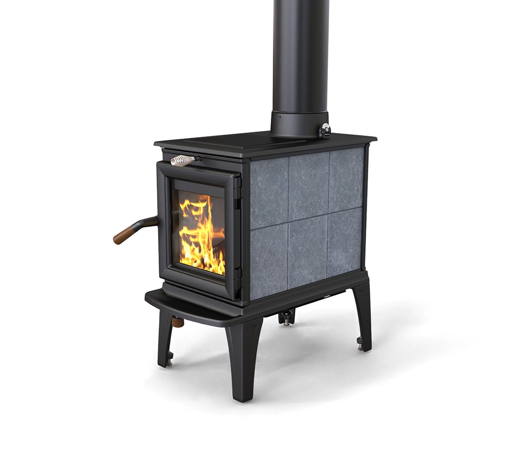

I currently own a Woodstock Keystone. This is a catalytic stove that sits on a hearth and vents to the rear. It is a side loader, so it has the convenience of a north-south load but reduced clearances in the front. The side load means it is easy to load and adjust my load without smoke spilling out a front-loading door. It also has an ash pan, which I like. It burns longer and slower and has a more comfortable, softer heat than the Lopi (not that the Lopi was bad). I also don't need a fan with it (less noise - important for me) since it wasn't recessed in a fireplace (like the Answer was). This stove is made in Vermont, so shipping will cost you, but it's a nice stove for a small space. I probably put 1-1/2 to 2 cords of wood through this stove mid-November to mid-March. It handles most of the heating needs of a 1750 square foot two-story well-insulated bungalow (in the same heating climate as my last stove), until it gets reliably below 20 degrees F during the day (lower at night) and then even three loads a day can't keep up with the heat load (understandable), at which point I supplement it with my radiant floor heating).
Both stoves have about the same size firebox, but the Keystone is heating a bigger, better insulated house and I'm more comfortable with the Keystone since the heat is softer and the stove doesn't peak at as high a temperature as the Lopi (it spreads the average temperature out over a longer period of time).
