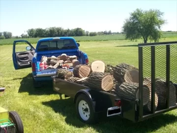

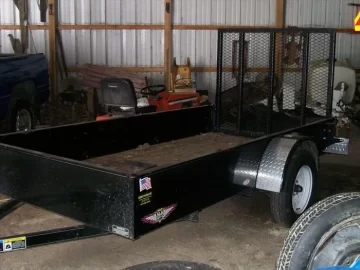

AP - keep in mind that typically axles (for smaller trailers) come in either 1500# or 3500# ratings. A 1500# axle with trailer will reduce your effective load to 1200-1300 pounds. A 3500# axle with trailer will allow the trailer an effective 3100+ pound load. Keeping yourself honest while loading, you would be able to load about 2000# on that trailer and be in your "safe zone" for the sooby. With a 1500# trailer you will tend to overload and still never get to a "full" hauling capacity.
I purchased (a few years back) a brand new 5 x 10 ft with fold down ramp and full sides with a 3500# rating for $1100. Big 15" trailer tires with spare to boot. These DO hit the used market and for firewood they make an awesome trailer.
(these trailers are also available in the 5 x 8 config.)

I hope you do. As you can see from the first post - I ain't afraid of loading it down. That run was only a couple of miles of rural road, but the trailer handled it like a champ. I also tow it behind my Grand Cherokee and it will handle trailer and load VERY well. I think if you kept your head on while loading, your sooby will do pretty good with it. (I don't think you would want the load in the first pick behind your sooby - that weighed in at about 4400# :ahhh: )

This is exactly the type of trailer I would like to get. Could you please share the make/model/whatever?
http://www.hhtrailer.com/
It appears that they are under new ownership.
A quick run down:
3500# axle
solid sides
folding full width ramp
15" trailer tires
2" ball hitch
Full treated 2x10 deck - 5ft x 10ft long.
full channel iron frame
D hooks inside and rail loops for tie downs.
The thing tows like a dream.
Hope this helps.
