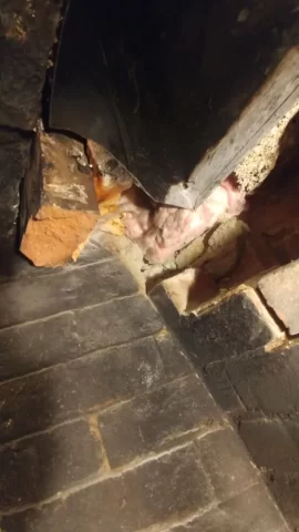

I had to re-position some bricks in the fireplace opening so that I could pass stove pipe through it. I could see the poured in insulation, and there were obvious large voids which upon investigation were found to be filled with SPRAY FOAM. This is right in the fireplace chamber.... one brick thickness away from the flames in my fireplace. Some of this spray foam was CHARRED and MELTED and STUCK to the BRICK! I will try to find the photos I took of it. Is this normal or accepted practice?
It takes 20 seconds to spray a couple cans of foam in there, and I can't tell you how many hours it took to locate it, remove it, and recement all those bricks back in place. This was done by a "certified" chimney guy that is still running around.

Here are some photos of the spray foam removal. Has anyone ever encountered a situation like this?
I thought this foam was combustible. They might as well have stuffed it with newspaper.

I would be very troubled should I find that scenario in my home, wow. I could understand rockwool as it is not suppose to burn but would not be happy with fiberglass insulation either. If your stove and stove pipe temps are not running away from you and easily controllable with the stove air intake itself why bother with a damper, no need really.
Yes, the ceramic type insulation would have been fine, but expensive.
There was some pink fiberglass too... and while I roll my eyes at it, I did not freak out about it. I mean, it seems to still be allowed by certain jurisdictions to close off a fireplace opening around the pipe from a wood stove with plain old fiberglass.
But the foam.... this stuff seems to really burn well and hot (in addition to giving off chemicals at the start).
