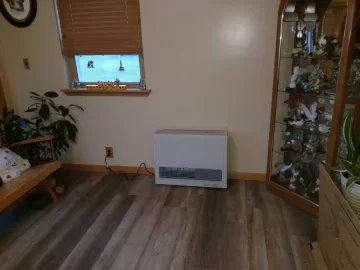

I just installed one in a Florida room. The couple was ecstatic how well this medium unit heated and efficient. The stainless vent is attractive and awesome technology.
