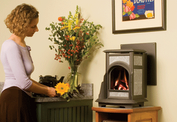

I always liked the look of this one.
  • Small LP Stove for kitchen

It looks like that stove doesn't put out any heat! Must be cold! :lol:
