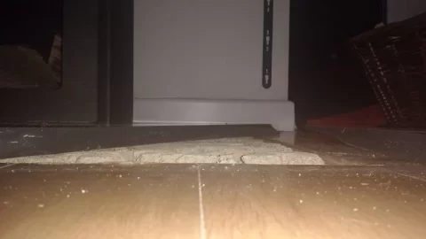

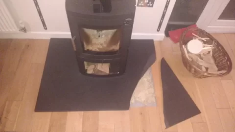

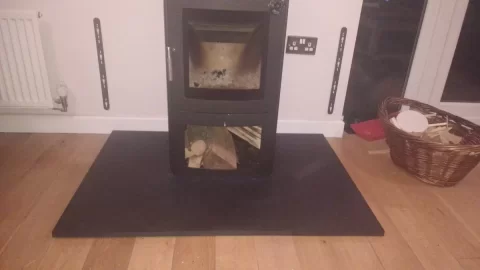

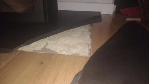

Hi folks - first time poster. Hoping you can help me.
We recently had a 4kw wood burning stove installed. The stove sits on top of a single piece of slate that measures 1100 wide x 800 deep x 20mm thick.
Underneath the hearth stone there is a section of floorboards cut out, so a recess which a little smaller than the dimensions of the slate. The hearth spans this void and sits on top. The installer put some cement down in the void under the stone.
A few weeks after installation, the slate cracked right across from the front to the right hand side, when we put a basket of logs down on the front right corner of the hearth.
The installer visited again to work out what caused this. His advice was that the floor is not completely flat and because we used slate, which is a 'natural stone' and has imperfections, it has cracked under the weight. Looking at it now, I can see there is a gap of about 6 or 7mm under the front left corner, and the hearth is 'floating' unsupported, whereas the back left corner is flat to the ground. I imagine if I put anything heavy on that front left corner it would probably cause another crack.
So I would like a second opinion on what has caused the hearth to crack. You'll see in the photos how the installer put some cement into the void. Do you think that's sufficient to level and support the stove and hearth stone? Should the installer have used anything else to support the edges and ensure the stone was level and supported all the way around? In your opinion, what is the best way to rectify the situation?

Yup unsupported. So unfortunate, and yes stone has "grain". I have Marble and the same thing had happened from the previous owner. Unsupported and it cracked. Last week I bought slow curing epoxy and fixed it. I bet if I mixed up a little marble dust I could make the fault line vanish.

Don't know what the process is normally for installing a piece of slate like that for a hearth, but it certainly looks like an incorrect substrate underneath. That wouldn't fly for a tile floor. Any gaps or flex to the subfloor will cause a large piece of slate to be vulnerable to cracking. I'd be tempted to get a second opinion as to the correct way to lay that (or wait for some forum members to chime in).
Should have had more support under the slate . . .
My memory may be going . . . but wasn't there another person here from the UK that had cracked slate from an installation . . . not to this degree though?

So are they offering to replace it? In my opinion depending on hearth requirements it should have been self leveling compound used. Would have found its own level and provided a stable flat surface. Even if that one corner was to be "fixed" who know how supported it is in other locations. If for hearth requirements you were to use concrete or motar or something similar it seems like it should have been troweled flat atleast. That just looks like the old "throw a few globs in there, SHOULD be fine" mindset. Just my 2 cents

Unfortunate. Slate can be very weak if not set perfectly. However, was this whole hearth installed by the same contractor? If so, my thoughts are that they should bear some burden in the remedy. It looks to me like it was a erroneous install. As mentioned, the floor should have been cut away to encompass the entire slate piece and then self leveling compound utilized.
Make the installer redo it. The correct way. As stated above the entire stone should have been supported by the mortar bed. Some sort of extra framing and support should have been done directly under the hearth area. It also appears the installer did not do a good job cleaning and or buttering the back side of the stone due to such a large piece breaking off.
Very much the fault of the installer. Stone must be supported, not left to float out in the air.

Strength really has nothing to do with a hearth surface. You can have glass, and as long as it's properly supported underneath, it won't crack. For there to be a crack, there needs to be some give. There should be no give at all in a proper install.
I would have use a 1" deep bed of beach sand . Set the slate on it , then vibrated to settle the sand under the slate. The edge would have to be finished somehow to keep the sand in place and allow for a clean edge.

If I were laying that pretty piece of slate I would lay a bed of mortar one inch thick, on top of the plywood, and put the slate on top of that. That way, there would be direct contact between the entire piece of slate and the mortar, no 6 mm gaps.
