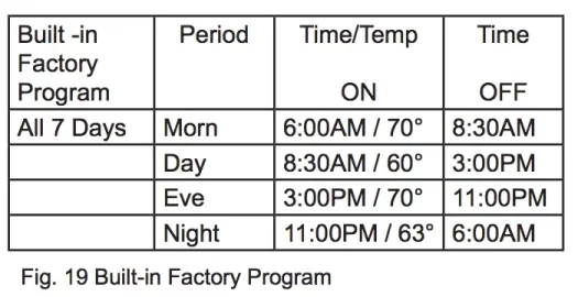

What I would like to do is program it to start up on it's own at 5:30am and hit 70 degrees. Has anyone figured out how to do this with this thermostat? Countdown is one option but the manual (which i've read several times) says that it only keeps things 'ON' and then turns them off after time expires. Would it also turn it on after time expires?
The programs dont allow for "turn stove off" just times and temperatures.

Time and temp is all that is needed. Set for a lower temp, say 60F during sleep hours, say 10pm to 5am and then to 70F at 5:30am. It will turn off the stove when the temp reaches 70F and will turn it on again when the temp drops below 70F. The factory setting is pretty close to this.

Just set the night temp to something very low like 50F.
Solution:
Change thermostat to "prog" and move pellet stove console setting from "hi/lo" to "auto/off" before heading to bed. (since i like hi/lo during the day and the thermo mode on the thermostat). Make sure it is on the level that I want for the morning.
First, program thermostat for 50 degrees at 10pm, and 70 at 5am for each day.
At approximately 10:30 the pellet stove will shut off since there will be no call for heat for 30 mins. At 5am there will be a call for heat and the pellet stove will start up.
This assumes the temperature will not drop below 50 all night. In my case I have the baseboard on 55 so i'm assured it will not.
