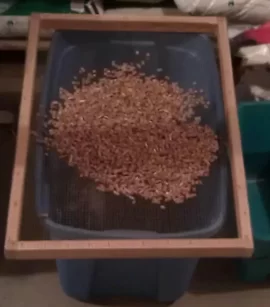

tjnamtiw said:In my experience with my sifter, 1/4" wire mesh is too coarse and you'll get a lot of small, USEABLE pieces falling down into the scrap bin. It is really only the dust you want out so I topped my 1/4" mesh with the coarsest window screen I could find.
imacman said:Yep, that will work....just pretty time consuming.

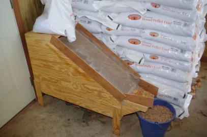

tjnamtiw said:This is what I use. Takes no effort. Put the bag at the top, cut the corner out, and let the pellets run down into the bucket.
