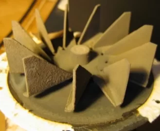

I used this on the comb. blower fins and it worked well to reduce the build-up of carbon:

forya said:The max temp on that graphite lube it 850F is that ok for the combustion fan?
