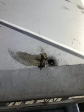

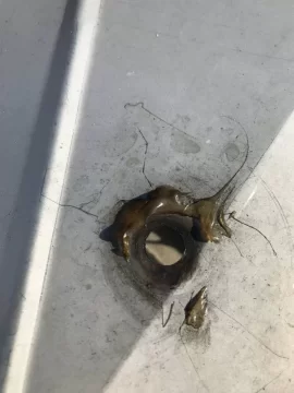

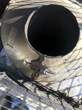

[Hearth.com] Silicone changing over time? [Hearth.com] Silicone changing over time? [Hearth.com] Silicone changing over time? went up to check the top of my liner to see if mid season sweep was needed. It appears fine for now with some soot throughout liner, but top few inches having thin powers soot in small quantities, so seems good. While up there i noticed that some places where silicone was used, the silicone appeared brown and it seemed like there was less of it there than I recall seeing previously. My installer used silicone (not sure if it was high temp silicone or not) to seal where storm collar comes together. Storm collar surrounds my liner which then covered by a double flue metal cap. Installer put some silicone on the small bolts that hold the cap onto the screen of cap. He told me that the screws appeared a bit loose in general so he put a bit of silicone on each one so that the cap would not come loose.
Well, now there appears to be less silicone that sits atop the cap on those bolts than before and the silicone has taken on the color of brown soot (the color seems to make sense given that it could be discolored from the smoke out of chimney. I’m not sure what to make of how it looks like there is less silicone. Could this have burned off? The cap itself did not appear warped or anything like that. Have had no reason to suspect a chimney fire or significant overfire of anything. Put a couple pics up for the heck of it. Not sure if there is anyway to tell what, if anything, happened.
Silicone doesn't last forever. Just clean the surfaces and put more on. Had to do mine a couple of times, no big deal.
The install is only like 6 months old though.
That's because he just blobbed it on there, and didn't work it in with his finger. I bet he didn't clean the factory oils off the metal first either.
