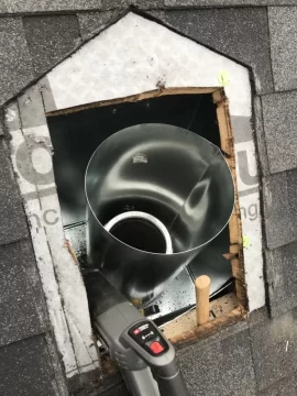

Again many people don't know they had one but even minor ones can cause pyrolysis of wood structure or ignite wood that was already pyrolized. Which is why a safe proper install is so important.
If you’re paranoid like me, install the attic insulation shield even though you don’t need it in a cathedral ceiling kit.
